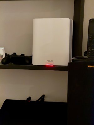

Not quite 2 weeks later and bam, one is offline, needing a manual reboot.
Just total BS.
