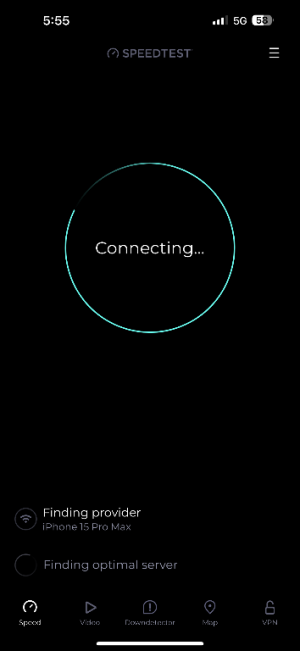

Sorry guys, but the new firmware does not fix the iPhone disconnecting issues. BQ16 Pro setup as router and 2 nodes, I just had my first disconnection after reverting from APs yesterday.
That’s disappointing, thx for trying and feeding back. Really bugging me (and probably others) what is the issue here ?? Grrrrr

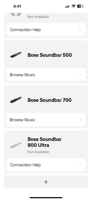

It’s not just iPhones, my soundbar was also disconnected
cannot see Sonos devices from IOS devices, however i can access using Android on network!
I have 5 Sonos devices too, so hopefully it's some local issue, or might this fix from the latest FW be a solution - 2. WPA Encryption Settings Update. Added new configuration options for WPA encryption, including the option to select AES for improved client compatibility. This setting can be found under "Network > Main Network" ?
Yes i have that enabled (seems isolated to IOS again) will bounce all devices...
