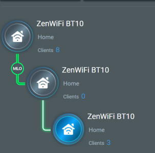

I have 3 x BT10, both 'satellite' nodes are connected to the main node. When I manually change the node that is furthest away to connect to the node nearest to it, MLO backhaul goes away on that node. Just like the screenshot below.
