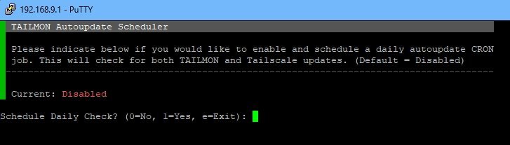

Cron job scheduler has been added to the latest beta... Please let me know if any of the wording in any of the added items is confusing or needs to be changed.
Updated to latest beta and found new option. Enabled and cron job and services-start script were both updated correctly. Now we wait for the next update... lol

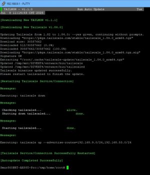

@jksmurf ... I know how eager you are to try this out. ;) Here are some early beta testing instructions... please see how this goes for you.
Thank you @Viktor Jaep, good to your word, as always; and thanks to @rung for testing too, great stuff.

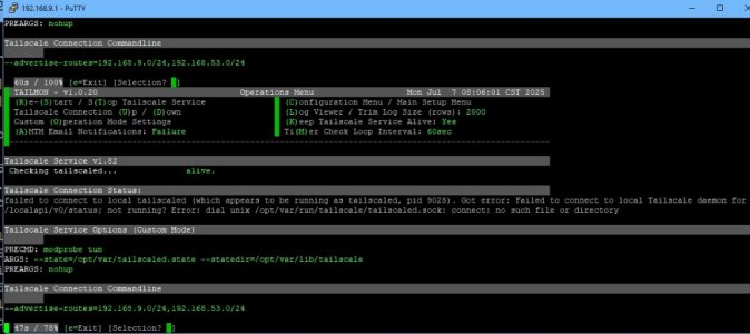

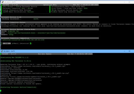

5. Expected behavior seen:
- TAILMON v1.1.1 will get downloaded through the autoupdate function
- Tailscale will get autoupdated to v1.84 through the autoupdate function
- TAILMON will refresh and update itself in your original window the next time its internal counter refreshes itself.
Success and failure emails are configured.
If this looks good from your end, I'll get a CRON job menu item worked in so we can automate the autoupdate check on a daily basis.
I don't use screen so wasn't 100% sure what to stop exactly, so I stopped the TS service and ran through the steps above.
Any odd messages that you see may be as a result of that; but feedback all the same, in case of others doing these out-of-whack installs :-).
I did not initially see item 7 in the menu above but probably not on the "latest latest" beta; restarting it gave me the menu (v1.1.1).

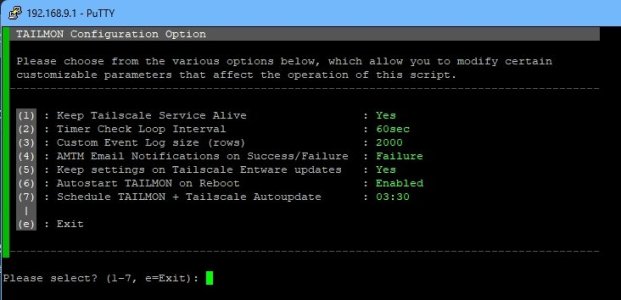

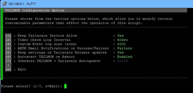

Minor comment for Custom item 7:
  • I would suggest that rather than just state a time there (01:00 in grey), that if it is DISABLED (being the default), that you just print (state) "Disabled".
  • It was not immediately apparent (albeit not green) that 01:00 in grey meant disabled, until you enter the menu.
I received a "FAILURE: Tailscale Service Restarted" email; not 100% sure if that was due to me stopping the service (rather than screen).
Again, thank you Viktor, this is awesome.
k.

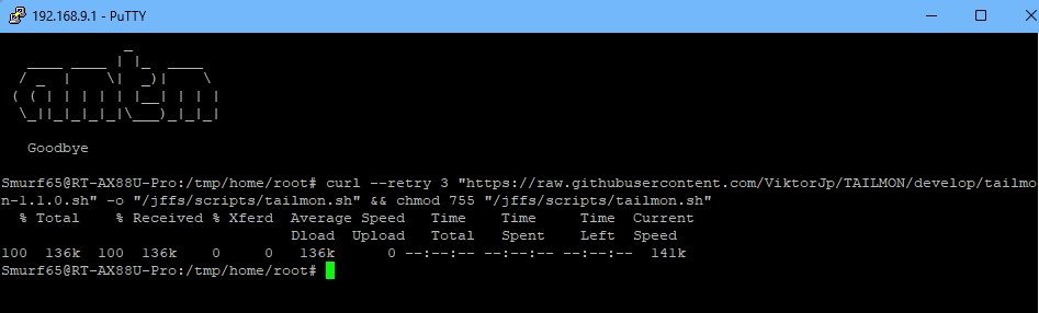

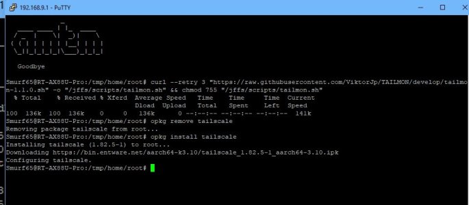

@jksmurf @rung ... Please update to the latest beta. Added the versions TAILMON and Tailscale updated from/to in the success emails and the logs. Also, added an event log item showing that the autoupdate ran successfully.
curl --retry 3 "https://raw.githubusercontent.com/ViktorJp/TAILMON/develop/tailmon-1.1.0.sh" -o "/jffs/scripts/tailmon.sh" && chmod 755 "/jffs/scripts/tailmon.sh"
If you want, please go through the testing steps to make sure everything looks good on your end! :)

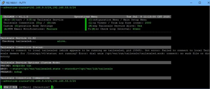

Done. Still shows that odd error on 1st SSH screen but has no adverse effect.

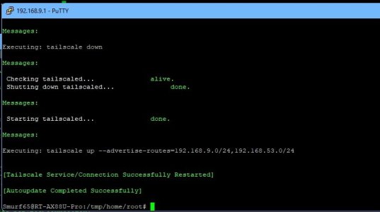

Followed the steps including that this time I started it with "tailmon -screen -now" :-)
HTH, k.
That is weird. Mine will actually stop and start the service when I encounter that error. Does that error message never resolve and just stays? Like you never see your device list?
