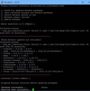

PUBLIC NOTICE! Entware just got a refresh here on August 9/10 (depending where you are in the world)... and so after you update entware, it will overwrite your latest 1.70.0 tailscale binary version with the 1.68.2-1 version that comes packaged with entware... which will require you to reinstall 1.70.0 from the tailmon setup menu... Unfortunately it's another step, but it was quick and easy to get back to normal.
Thanks for the heads up. Updated entware locally OK (without TS) but when I tried updating entware packages remotely, over a Tailscale (via Tailmon) connection it just got stuck and shut down tailscaled and didn't go any further (entware packages not updated).
Ended up using Wireguard (I have a WG server running on the remote router for emergencies if Tailmon doesn't connect), updating entware, then updated the TS ver 1.68 to 1.70.

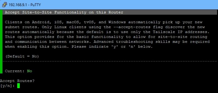

btw there is a preset Site to Site function to set it up on each router (see pics), but it might not be the more advanced setup you are after.
