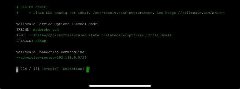

I’m running kernel mode in a very simple setup and can access my WebGui remotely from anywhere (tested 9000km away).
