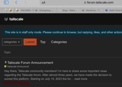

Tailscale’s own forum was sunsetted (see pic) a year ago but still has lots of descriptions on setting up Tailscale.
For general tailscale setup Tailscale’s own documentation site (see menu on LHS) is pretty good.
Then there’s the Tailscale Reddit and for the more technically-minded folk, the Tailscale issues site on GitHub.
Not to turn folks away, just to point out other resources for general Tailscale configuration and troubleshooting, independent from TAILMON.
