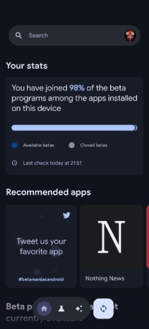

@rung just OOO what are you seeing in the latest Tailscale beta that makes that beta worth updating to (and now maintaining via TM)?
Great work Viktor!
Stuff being stable and not breaking every now and then is boring?
Or better me than someone else?
Completely normal reasons if you ask me... 😜
But seriously, if it's not extremely critical, I rather live with a few issues and spend some time reporting the problems I get.
😂 yeah all good, I am ok with betas on my local system, my remote set 9.5k km’s away, not so much!
Was just curious I guess, as in what am I missing out on, is there a cool all singing all dancing new feature, does this beta finally fix that irksome health warning message e.g, that sort of thing.
Yeah. If it's too much of a risk it's a bad idea. But if some failures don't hurt, why not help out. That is the way I think.
Getting early access to something new or just general improvements is just a perk on the way.
I avoid betas on my server though 😉
I am on Beta Tailmon but stable Tailscale.
