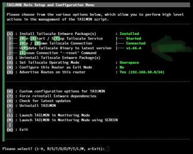

I was thinking about this overnight as it bugged me a wee bit. If "tailscale up --ssh" worked for you with Tailscale on the Router that was not installed using Tailmon, I am guessing it should work in Tailmon too.
So, with this in mind, have you tried entering your "tailscale up --ssh" option in a Custom Tailscale Commandline?
i.e. from the Tailmon Menu, select (C), then (3), then (3), then (e), then after restart TS prompt, (y), then (4), then replace your current commandline that runs "tailscale up --ARGUMENTS" (normally set by Tailmon) to e.g. for my machine:
--ssh --advertise-routes=192.168.9.0/24
then (e), (y) to restart. You can amend the line via the (O) option later if you make an error. See sequence (roughly in order) in the 18# screenshots on imgur.
It appears to work for me, although I had to wait a little while (and go into the Tailmon screen to check the SSH Connection was listed) but I was able to connect via SSH using the Custom commandline which adds arguments to tailscale up. I reverted to Kernel mode and removed the ephemeral SSH instance using the procedure noted above (see also pics in the post above).
I did have a bit of an issue when I reverted to just Kernel mode in that the connection remained disconnected, showing "Tailscale is stopped".
I could not get it restarted despite selecting (U) for Up, and changing to Kernel or Userspace mode; nor via a Router reboot. When I tried (T) from the main menu I got an error about Tailscale needing a --reset. Fortunately @Viktor Jaep already included such an animal in the main menu (C), then select (I), so I reset it (whereupon it connected again), and then I changed to my preferred Kernel mode. The green SSH flag also disappeared from the Admin Console as expected. All good.
@Viktor Jaep provided this works sufficiently well (maybe @ColinTaylor or @Brenneke can advise after they try it on their own machines) if the "--ssh" argument is something you think would be a good default addition to the built-in set of Custom Options, that other users could add?, do you think you could add it in? Or simply not enough use?

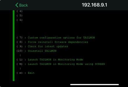

HI. I have a TAILMON script installed from AMTM in my asus merlin FW which I use to connect devices. After Sunday's reboot of the RT-AC68U router, TAILMON does not want to start. When I log in via SSH and start TAILMON, I see an attempt to constantly start the service. On the console, I only see constantly repeating attempts to start the service with the result FAILURE. I ended the TAIL process via SCMERLIN-KILLPROCESS. Now I do not receive emails notifying me of FAILURE until the next router reboot. The problem is that when I start TAILMON, it automatically starts to start the service cyclically and I cannot get into the settings via C or other letters.
I might have had this issue before at one stage.
IIRC I did one of these things (cannot recall which worked, sorry)
  1. D, T, R (TS Down, TS Stop Service, Restart). I am not sure you can get to this menu, if you cannot get to C.
  2. C, I, which does a reset for you; or
  3. C, 8, which installs Entware dependencies; or
  4. I did a repair install of Entware; from amtm, ep, 4, 2. This might mean you have to set up some configs again but at least you can get past the error.
You won't be able to do 2 or 3 if you cannot get to C.
You could, all going pear-shaped, from the command line (not in Tailmon), simply try issuing
tailscale --reset
Let us know how you get on.

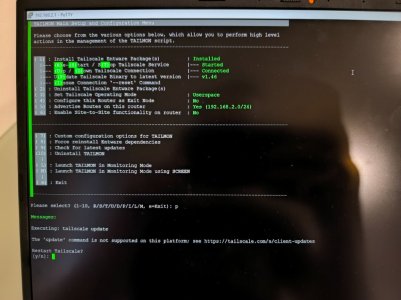

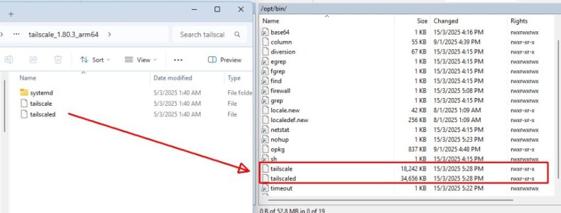

OK. It works. Thanks for the answer and advice. The command did not help. Reinstalling all EPs helped. Thanks for the advice. I noticed another warning. This TAIL runs on my old RT-AC68u and it gives me a message, see photo. I have the latest version of FW merlin and all packages are updated. What should I do or how to update this if possible?
What you should do in future, and I do not mean to be rude here, is read the introductory posts that @Viktor Jaep has spent a lot of time and effort putting together for this Addon. In particular you need to read this one, regarding updates to the tailscale binaries.
Having done so, and having searched the forum, if you are still not clear come back and tell us what you’ve done and where you are stuck, we’re really happy to help folks who show they’ve tried, whatever their level of expertise.
Having said that I had forgotten how old the tailscale binary version was for the architecture on the RT-AC68U, which is armv7sf-k2.6. The entware repository for that architecture does indeed show Tailscale v1.46 at first install, so that’s good, nothing astray there. Note that entware is EOL for that architecture but it doesn’t really matter for Tailmon as Viktor did a great job of facilitating users to always be able to update the important bit, the tailscale binaries.
On to the update, as I said, the post I linked above shows the (C) Configuration menu has an update function where you press (P) “U(P)date binary to latest version” and follow the instructions. That simple.
Hopefully that works out for you.

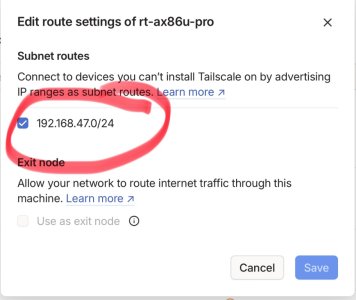

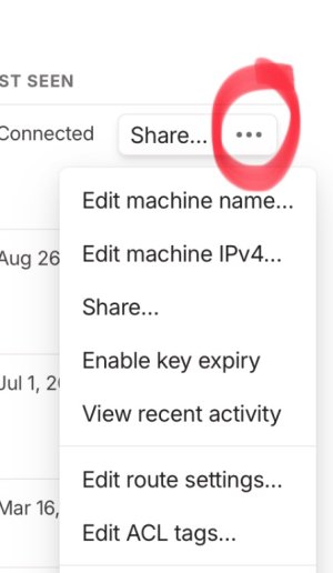

btw I noticed on your screenshot you have subnets but you have not checked they are to be used (I can see that from the blue text subnets!). If you want access via that router I.e. you have no other default subnet, then you will need to enable it from the Tailscale admin page. See screen caps below.

I tried updating the binary via the C menu and updating P after the initial installation, but nothing changed, just like today.
I am just starting to wonder if, because your architecture installs the tailscale_nohf version of tailscale, whether the directory structure is different or cause a slight issue when doing updates in Tailmon.
After @ColinTaylor and @Viktor Jaep got the older architecture installing OK, I never tried to follow this through with anyone who had such a machine, whether the updates also worked and I do not have this router. It would be nice to nail it down though.

Manual binary update:
  • Go here: https://pkgs.tailscale.com/stable/#static
  • Download the latest package, for my Router it is arm64, so currently I use tailscale_1.80.3_arm64.tgz; however for the AC68U, which is armv7, I am not 100% sure, I would need Colin to clarify, possibly 'arm' so for the RT-AC68U likely tailscale_1.80.3_arm.tgz??. Refer also [EDIT2] below.
  • Extract the binaries tailscale and tailscaled only.
  • WinSCP to your remote router and navigate to where the current binaries are (on my machine, which is newer achitecture, it is /opt/bin/). The caveat being that if you are using Tailscale to navigate to that machine, you won't be able to copy the files across, until you stop the daemon (i.e. stop TS running). I suggest to use Wireguard or another TS instance that runs on the same subnet and is a subnet router), but allows you access via WinSCP to the Router.
After the update, it prompts me to restart the TAIL service. When I restart, it understandably breaks my connection because I'm connecting remotely. After restarting TAIL, the binary version is unchanged.
Yes, that little WTF is happening pause can be worrisome; especially remotely :-).

I finally got around to testing with a negative result.
  1. Uninstalled TAIL.
  2. Uninstalled EP with a complete AMTM reset, so I removed all the packages I had there. The router was restarted.
  3. The router firmware is on the latest available version.
  4. Forced an AMTM update – I’m not exactly sure what that means because no update was available, but there was an option for "force update" :) so I guess it just reinstalled AMTM.
  5. Installed EP.
  6. Installed TAIL – after installation, it had the same binary as before.
  7. The update did not go through, see the photo.
