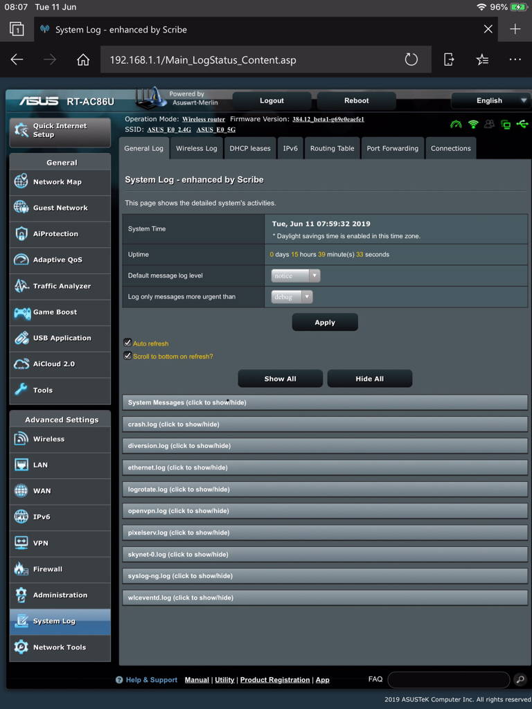

1. Uninstalled and reinstalled 4.1, same problems. The two squibs at the bottom are partial snips from the block source lines in the /'jffs/scripts/uiScribe.d/.logs file.
2. .logs contains a line for crash.log and wlcevent.log, neither of which I have on my 87U (I think this is peculiar to the 86U, yes?)

You have lines for crash.log and wlcevent.log because filters for those logs are in /opt/etc/syslog-ng.d/ -- uiScribe looks for the logfiles listed in the filters, not the logfiles that are actually in /opt/var/log.

@elorimer - it generates the list of log files from the configuration that would be loaded if you restarted syslog-ng, Usually this should be the same as what's loaded into the running copy of syslog-ng, but if you've recently copied files into the syslog-ng.d directory then it will look for those log files even though the filter might not actually be active yet.
Note, however, that it ignores any file statements that don't have '/var/log' in file statement. This is because there is an assumption that you any files you are sourcing (like the logrotate status file) won't already be in /opt/var/log. However, any logs you are sending elsewhere for some reason also won't be shown on the webui.
Oh yeah, I already forgot about that. Duhhhhhhhhh
Actually any path/extension should now be shown, but due to my (lazy) pattern matching, if there's anything after ") for the file path (e.g. Template) it is incorrectly included. I should have a patch out tonight
Ok, so it will look for anything that is a (1) destination declaration that (2) is of the form "file("/opt/var/log/*.log"). It won't look for a source in that form, and it won't look for a filter.

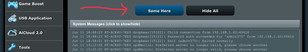

Found a bug for you. If I click on the 'Show All' or 'Hide All' buttons, an 'x' will appear and delete the button name(s). :)
Same here [emoji4]
