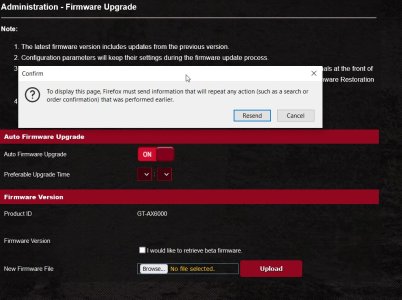

I have the same problem with my new AX6000 router. There is no option for me to browse file for upload or update button available at the GUI side.
I have tried different browsers, factory and router resets several times and same problem without the browse file and upload links buttons. When I disable the CSS to no page style at all the browsers, I can browse for files to upload. However, when I try to upload Merlin firmware, it stops at about 90% and boots me out. The router returns to its default Asus firmware version 3.0.0.6.102_21514.
I remember there is a John application in the old days that enable firmware upgrade via Telnet? However, I have lost the application and I don't know whether it will still work for this new router.
Any help or assistance in this area will be greatly appreciated. Will also be great if you could kindly provide the guide as I have tried to resolve this problem for several days including sending emails to Asus support but no resolution for this problem.
Have you tried option 3 shown in your screenshot? How about the suggestion in the post immediately before yours?

What happens when you toggle "Auto Firmware Upgrade" to "off"?
I have gotten it fixed. Thanks to the fellow here for advise on going with restore option. Once restore back to Asus fw. All settings till intact and you can just upload the latest Merlin fw. Thanks so much again all.
Once I toggle on and off the browse file and upload file links appear but firefox pop up an error (other browsers no error but revert back to original status where the link disappears). Once you click the "resend" or "cancel" or "close" the firefox pop up, the browse file and upload buttons disappear again.
Looks like you have something preventing the pop ups maybe browser extension, anti-virus, look for something causing it. Review the method you use to initialize/restore to factory settings of your router, flush your browser's cache then start over.
