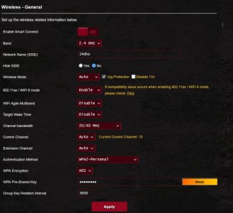

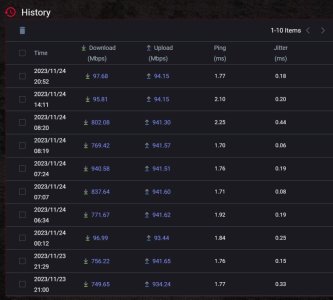

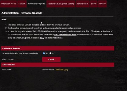

The speed test results can be a drastic differences at certain hours with version GT-AX6000_3.0.0.6_102_21514. Sometimes the wireless 5GHZ signal can reach as high as 700 mbps download speed. However on the second half of the day (after 2pm), it just hover around 95 mbps (very very low since I am subscribed to the 1G plan). The speed will go up again after 11pm. The direct lan speed connection to the modem is almost consistent at 950 mbps.

ASUS support has not come back to me with any resolution yet and meantime I am still trying to see if there is any tweaking to the wireless settings that will improve the situation. Attached is my current settings and will appreciate if any one with good connection can post their wireless or relevant settings here.
If that speedtest log is the router's internally, then it's obviously ISP throttling / congestion, which, by the times you stated was my guess before even getting to the attachments...
I guess you are right in the speed issue. I managed to contact the ISP technical support and they claimed it was the lan cable from ONT to Router and ask me to replace and monitor. So far so good after replacement and I can easily hit above 100 Mbps.
