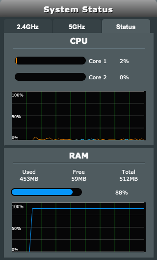

Although I understand the questions, no one is questioning stubby+dnsmasq as a waste of resources.
My CPU and memory have never worked so little. The only memory-intensive process is Skynet.
This makes it difficult to organize other solutions for this project.
Agreed. Same here, never seeing a single core (idle) going above ~1-3% usually at 0%. Running Diversion, PixelSrv-TLS, Skynet, AIProtect IPS, and Unbound (no stubby).
As a side-note, I noticed whenever my memory usage is high, I ran: free -m command. Most memory is just being used as read / write buffer as is standard with linux: https://www.linuxatemyram.com/ (sorry this website puts it so bluntly, lol). Anytime it reaches ~96% the buffer clears, and I am back down to about 63% RAM usage (at most).
