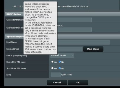

Current options for WAN DHCP query frequency are:
  • Normal: When router does not get a response from ISP, send another query after 120 seconds and make 2 more attempts.
  • Aggressive: When router does not get a response from ISP, send another query after 20 seconds and make 3 more attempts.
  • Continuous: Not defined in tooltip. Presumably initiates new DHCP request as soon as previous request times out.
As described in the tooltip, "some ISPs block MAC addresses if the device makes DHCP queries too often." This problem is compounded when some (too many) ISPs' DHCP servers are unable to detect when their own last mile routing drops and reconnects, believing the router to be requesting a /2nd/ IP address when it receives a DHCP query but doesn't realize yet that the previous DHCP-assigned IP is no longer connected (due to its own last mile disconnect, usually only for a few seconds). Worse, such ISPs have their DHCP servers configured to /escalate/ the block if a new DHCP query is received after a MAC block is already in place. The result is that even in Normal mode, a router can get indefinitely blocked from getting a DHCP IP address from the ISP because the ISP punitively escalates the block time for each request.
Suggested solution (and feature request): Additional option for DHCP query frequency of "backoff mode". Ideally, the backoff timings would be user configurable, along with number of attempts, but if a simple 4th option in the pull list is preferred, something like, "When router does not get a response from ISP, send another query after 120 seconds, and then make 3 (ideally with an option for unlimited) more attempts. Each query after the first query will be delayed by double the previous query time delay, i.e., 120 seconds, 240 seconds, 480 seconds, etc."
Reasoning for feature request: This problem is common to many ISPs and the solution is not ISP specific so won't lead to issues with having to maintain ISP specific code. Solves problems where disconnects, both intermittent short term, and medium term eventually lead to a situation where either the ISP's DHCP blocks the router from getting a WAN IP address indefinitely (leading to a need to disconnect the ISP modem for a lengthy period to reset); or, the situation where the router DHCP requests give up after 2-3 attempts and then stop trying to reconnect to WAN until user manual intervention (e.g. reboot) is done, which can be a frequent problem in the case of sufficiently common ~6-10 minute outages without it being clear that the router gave up trying to connect to the WAN DHCP and won't try again (nothing in the log files about this, so many users assumed it would keep trying indefinitely, myself included); or, solves both.
It's my suspicion that many (though not likely all) of the reported "ISP DHCP Not Functioning Properly" problems frequently reported in other threads could be resolved with the addition of this feature.
