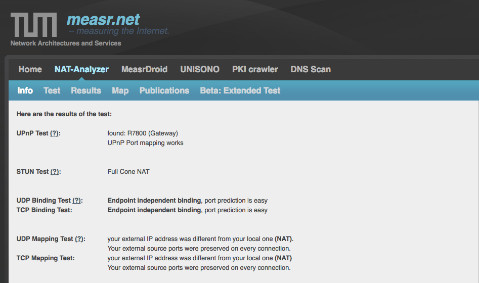

Nice little thingy man. Heres my results for the R7800:
http://nattest.net.in.tum.de/individualResult.php?hash=6bb3221b01a4e167f0badf30638c8e99
Say Full Cone NAT for the R7800. Going to run this test on other routers I have.

Seems to be FULL CONE NAT on the R7800.
At any rate, nice tool to find what router is using for NAT kind. I'll start using this and put the GT-5300 back online later today and start collecting data. This is good stuff. Just what we needed.

The GT NAT will be 100% identical to any other Broadcom-based Asus router - it's the exact same NAT code.
I know for a fact that the R7800 uses proprietary NAT code, it's not just speculation:
merlin@ubuntu-dev:~/netgear$ find R7800-V1.0.2.32_gpl_src/ -name ipt_CONENAT.ko
R7800-V1.0.2.32_gpl_src/git_home/kmod-conenat.git/ipt_CONENAT.ko
Again, you guys are just putting far too much emphasis on the NAT type... And you need to look at the more important fact that Full Cone NAT *IS* a security risk versus more restrictive NAT types. It pretty much nullifies part of what an SPI firewall does.
Security should be far more important than having two consoles report a magical open NAT mode. If games need that security issue to work properly, then the game code is broken, and needs fixing.
