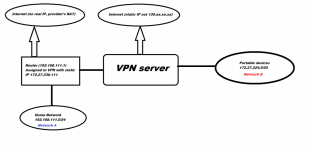

I want to try to clarify the situation more. Please look on this picture:
So the task is:
1. Network A and Network B should see one each other.
2. Network A should have internet access through Router, not VPN.
3. Network B should have internet access (does not matter how really).
4. Router acts as gateway, DHCP and DNS for Network A.
I know - this is disadvantage of OpenVPN-AS, but it is really the easier thing to work in Oracle Cloud.

So now I need to add appropriate push route commands only in router's client config:
route 172.27.224.0 255.255.240.0
And - voila!

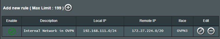

With the latest Merlin updates introducing VPN Director all above mentioned were broken.
I believe the following will solve the problem, but being at home cannot test it yet:
If somebody has any idea on this - it will be of use.
