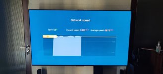

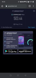

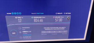

I just tried it on 3 different devices. My TV, my Xbox and my phone. They are all getting good speeds. I also factory reset my router and tried out 2 different ethernet cables. It's just my gaming computer. I'll try iperf tool later today and update. I am just totally stumped. I think it might be a windows issue.
