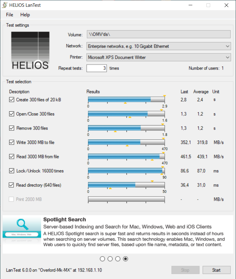

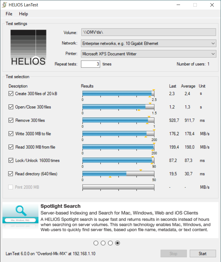

The target it my DIY OMV NAS with a 10Gbps Aquantia card in it and regular old spinning rust, using SnapRAID.
Realtek 2.5Gbps
1565453698101-png.128915
Aquantia throttled to 2.5Gbps.
1565453231357-png.128913
Aquantia at 10Gbps.
1565452905235-png.128910
