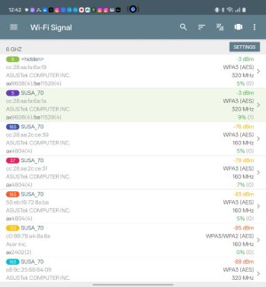

I moved the GT-BE98 Pro to the den and made it the primary router while changing the BE19000Ai to AP Mode with a static IP. After some thought why not add the BE19000Ai as an AiMesh node, (expecting AFC to stop working). Logged into the Ai router and went to settings, selected the third option for AiMesh node. It warns the router will be reset so it can be added as a node, and I continue. I go to the BE98 Pro and add it. It first backhaul's with 5 GHz, (strange as I have 10 Gb Ethernet Backhaul connected). I click Optimize and it switches to 6 GHz backhaul. I switch preferred backhaul to Ethernet just to check and it works, switch back to Auto and it moves back to 6 GHz.
What's the power output of the 6 GHz in the center of the antennae? I know Low Power is -3x dBM, and Standard Power is -3 dBm. Standard Power is still operational!

I realize I should wait about 24 hours before claiming Standard Power still works. It just has not reset it to Low Power mode until the 24 hour communique with the server either happens, or not.

Unfortunately I've already found that Low Power mode has been restored as an AiMesh node. The 6 GHz LED actually turns a different color when Standard Power is on. Now it is matching the other WiFi LEDs colors, (most of the rest as well)... Power is definitely down at -27 dBm:

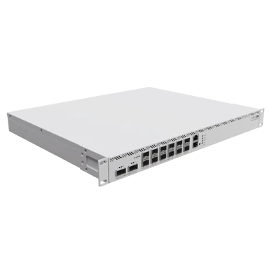

I look at something like this, and I think $899.99 is 1/3 of the price...
There is actually SNB Forum member with very similar Gateway.
I don't know what they are using it for. Local neighborhood ISP or something. 🧐
