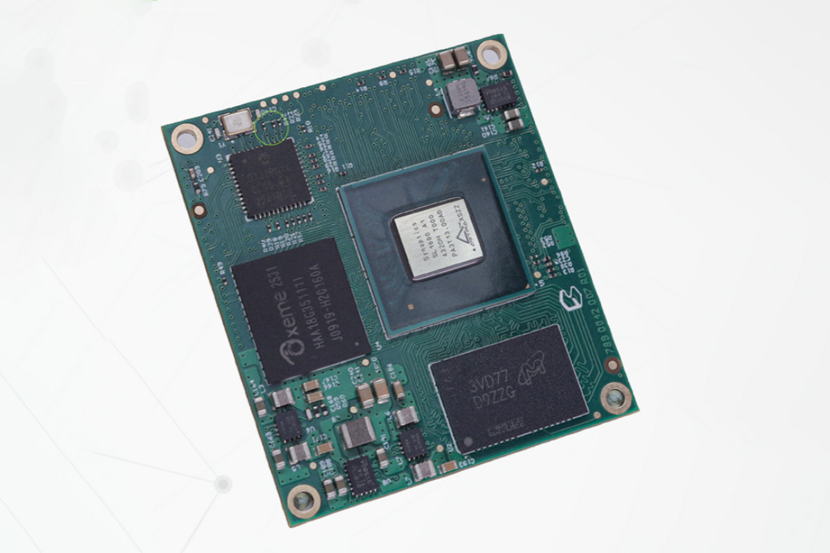

For those that are interested in some more details about the secondary SoC, CNX Software has some details on a SoM with the same SoC.
It seems like Synaptics is stuck on Linux Kernel 5.15, which isn't great, but it's at least an LTS kernel, for another year, but 5.15 was released 2021...
Based on my experience with these kind of SoCs, it's unlikely that Synaptics will move to 6.x, but not impossible. It also means that the GT-BE1900AI should be on 5.15 for that side of things.
