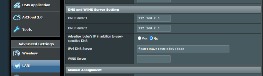

I've changed my settings to this with my pihole as DNS server in the DHCP server tab.
Devices are shown individual in Pi-hole, not all as router.

You are right, now everything is shown as traffic is from my router instead of the clients...
Using LAN> DHCP Server : DNS Server 1 & DNS Server 2 supplies the DNS server addresses to clients when they are provided with settings by the DHCP server. It doesn't force them to use the DNS servers, it's more of a blunt suggestion.
If you want to see what devices are ignoring the DHCP supplied DNS then you can find them by looking at System Log > Connections: and then sort by the destination port.
When you find out which devices are ignoring the suggested DNS, you can add corresponding entries for those devices to DNSFilter. By not using the "Global Filter Mode" you'll still get log info on the Pi-Hole for all the other clients.
