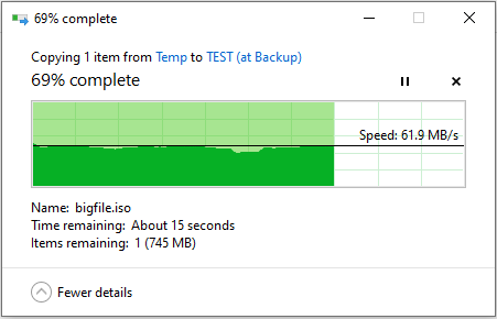

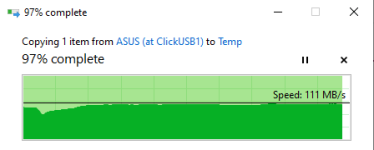

View attachment 47585View attachment 47586
Do you mind running this test again from the computer to the router? I also have a ax86u but with a intel ax200 and the upload speeds are 45MBs-50MBs. Download speeds from NAS are normal.
The only thing I have to test with at the moment is a mechanical laptop HDD plugged into the router. With that I can get about 60MB/s with a CPU load of 70% on two cores. It's spending most of its time waiting for write I/O to complete. I'd guess that if you were using an SSD you might be able to squeeze 80MB/s out of it, maybe more if it can use more cores.
