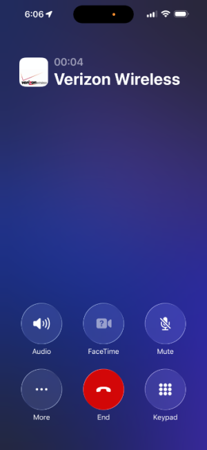

Here's how it shows on my Iphone. It also shows it on the lock screen.
Thanks, I don't think mine is working based on your picture. Also, my cell signal is typically not bad, but it jumps and that's why I was trying to get this to work, and why I thought it was working until I read this thread. I'll consult Verizon support s well as other resources to see if I can get it to work just to help balance quality of signal. Also since 611 is internal to the Verizon network, I wonder if it's not the best test, and I need to call a number outside the network.
OK, guys, I fixed WiFi calling. Here is what I did. First I passed Gemini the problem, and the suggestion was to turn on Airplane mode, and then enable WiFi to force a WiFi connection as Verizon is known to prioritize cellular over WiFi for calls. So, that's what I did, and then called their test number. After doing the Airplane mode trick, I got the VZW-WiFi status as I told I would if it worked. Turning off Airplane mode kept the WiFi status as shown in the two screenshots below. So looks like I'm good to go, and if I want to use WiFi calling, I just need to force it to switch. Probably the main reason it doesn't automatically is I have good enough cell signal that it doesn't switch on it's own.
