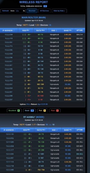

Wireless Report Wireless Report AiMesh v1.5.4 [2026-Apr-23] - WebGUI Table of all AiMesh connected devices (available in AMTM!)
v1.4.3-minor changes to router detection.
Thanks @JB_1366 for quick turnaround with new scripts - latest snapshot after second beta script works perfectly fine

I'm not sure which of the recent updates may have changed this, but one of my devices now shows "Wireless" rather than the connection SSID on MAIN. Another device on NODE connected to the same SSID is displayed properly.
It was previously working correctly. I just checked for updates and I'm using WR v1.4.4.
v1.4.5-enhanced router detection, added right-click sorting of node-hostnames, sorts numerically by node device (ex. 1-3, 3-1).
