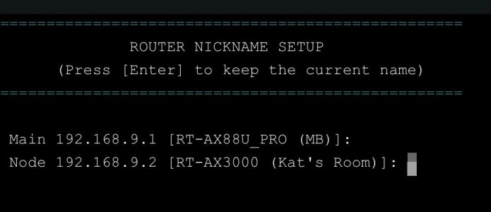

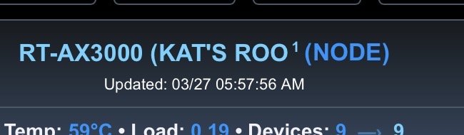

Not sure if it’s the brackets or a limitation on number of characters but I’m seeing a truncated name. I’m guessing characters, which makes sense. No biggie and not urgent but could you perhaps add (max. XY chars) to the install note for that function 🙏
RT-AX3000 (Kat’s Room) is 21 Chars incl. spaces. It gets truncated by 2 so it would seem you allow about 19 chars?
Yours are about 16 or 17 so I’m guessing a limit of about 18 or 19.
I put a max of 20 in script, so you couldn't go crazy and wreck the header, think I should bump up to 25?
TBH 20 is probably fine but 25 could help those with only one node (the irony being they don’t get confused by nodes with the same name, which promoted the request in the first place).
Folks with multiple nodes will struggle but having the flexibility for Main and single node users can’t hurt. It allows you to put model and a nickname. Hopefully they won’t complain when it looks awful on their 5 nodes…
v1.2.1-change nickname max to 25
