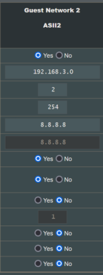

Hey guys I hope this is the right sub-forum to post this. I have a RT-AC86U with latest merlin and I just SSH'd into my router and ran the command to install YazFi.
I'm quite new to routers and things like this and I was under the impression I could run guest networks through my normal ISP without VPN, is that possible? My non-guest traffic is ALL ran through a VPN.
I have a OpenVPN client that all of my traffic runs through. Whenever it is active, by default, my guest network's internet is disabled for some reason. You can connect to the guest but there's no internet.
Like I said I am still learning this so any help or push in the right direction will be great
The settings in YazFi, do I need to change something? It's Guest Network 2:
My VPN client rule:

It's likely because your VPN Client is set to redirect all traffic through the VPN, but your Yazfi subnet is configured to not be allowed to use VPN to get out. So that's probably why you can connect to that Yazfi subnet, but not getting any internet... it's in limbo.
What @bennor was getting at is adding an entry into your VPN Director so that all 192.168.1.0/24 traffic will go through your VPN... Make sure your VPN client is then set to "Redirect Internet traffic through tunnel = VPN Director (Policy Rules)". That should then leave your 192.168.3.x subnet alone and allow it to just use your WAN to get out.
That works, thanks bro!
