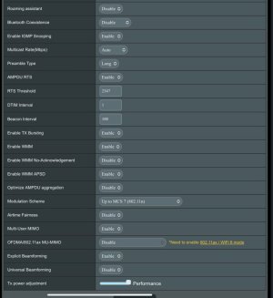

I forgot to mention that I have Roaming Assistant turned off in the Professional tab. I have found that it does not really work very well even on systems with an AiMesh node(s).
Since I am not running any mesh, it is certainly not needed.
It too will cause devices to disconnect because the router will disconnect them in an attempt to make the device switch to a closer node.
Make sure you turn it off on both wifi bands.
Also in the Proffessional tab, 2.4g band, I have the Modulation Scheme set to MCS 7 802.11n for best compatibility.
Here are my settings on the 2.4 band

Thanks you @Smokey613 for your help, I have made the changes you mentioned, I will test it for a few hours and I will comment on the news.
