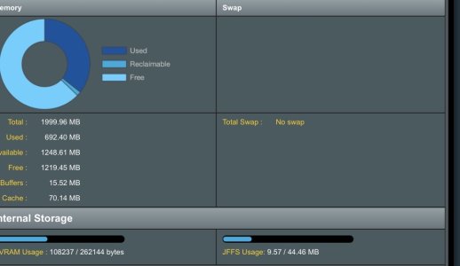

Updated and everything is working great for the most part on my RT-BE88U (Dirty upgrade but cleared the cache before update), except found a few issues that are showing up in the logs:
networkmap: Error locking /var/lock//usr/networkmap/nmp_conv_type.js.lock: 2 No such file or directory
Jan 23 03:14:20 networkmap: Error unlocking -1: 9 Bad file descriptor
Unsure what this is exactly, not sure if this is related it is it normal for the Swap section not to show anything?

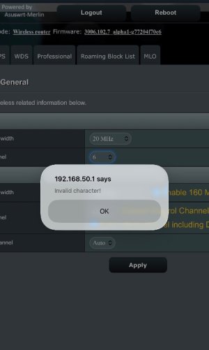

Another bug: When switching channels, this error keeping occurring once in a while.
Other than this, it works flawlessly, wanted to share my findings.
Both are perfectly normal, not a bug.
