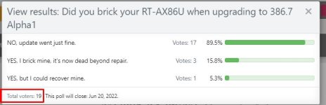

Did you brick your RT-AX86U when upgrading to 386.7 Alpha1
  • Total voters
    26
  • Poll closed .
AX86U flash the alpha over Asus 386-46061, reset and configure. Not using any addons All is well!

Poll: Did you brick your RT-AX86U when upgrading to 386.7 Alpha1 ?
Seems like the Polling "firmware" on this forum needs a bug fix ???
Actual maths:
Poll maths:
RMerlin to the rescue ??? :D
Actual maths:
Poll maths:
The maths is actually OK; I think what needs to be fixed is the ability for pollsters to give more than one answer, answers which are mutually exclusive.
The count in Polls such as these should always be on votes cast - not on number of voters who participated.
So the underlying maths is measuring the wrong thing in this poll - firmware upgrade required :) !
The options should be mutually exclusive, so the total votes cast would equal the number of voters who participated.
The way it's structured now, I can select all three options, which does not make any sense.
EDIT: I mean, one scenario where this is possible is if someone has three RT-AX86's and they each have a different outcome.

I can select all three options.
The update process was just fine, but on first reboot the router didn't boot up. You were smart enough to recover it though. :)
