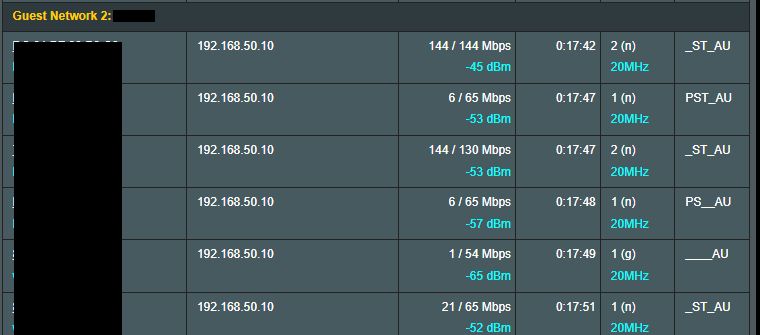

Something not look right with the assigned iot in guest2, they all show having the same IP's but DHCP lease and network map clients shows the correct IP assignments and they work as it should. Do you see these too in RT-AX88U?
