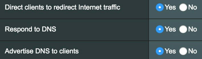

Can you post a screenshot of what settings you made so I can recreate it for my tests with my VPN provider?
I can then implement the findings in one of the next versions.

Same settings as @visortgw in the screenshot a few posts above?
did you men this screenshot? with this settings i solved ads if i connect over openvpn outside my local network...dnscrypt and your ab-solution script work together also....
sent from Kodi 17 Krypton
That is what I meant, yes. Thanks for confirming it works. I can make good use of such info's.
