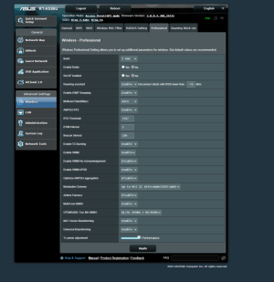

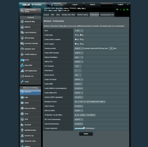

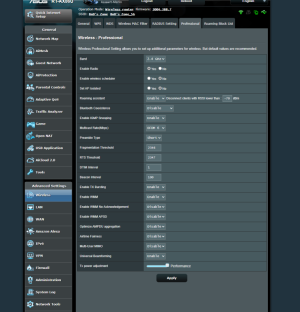

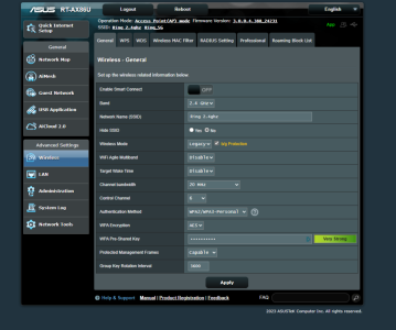

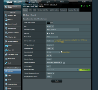

I'm not sure what info would be needed to see what the issue is, but I'll start by posting my wireless config setting on each router and I'll be happy to add whatever else may be helpful.
My main router wireless setting are below
Thank you for any suggestions you may have....greatly appreciated!

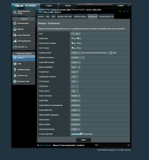

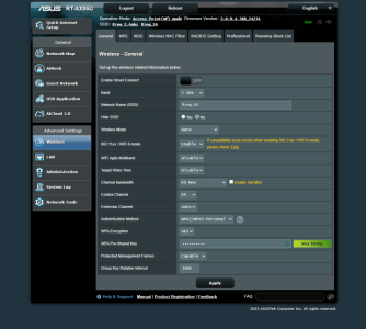

AP Router

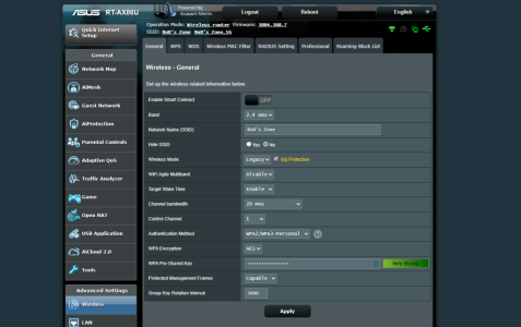

You have to stop playing with the settings first of all. Or at least get yourself familiar first what they do and what incompatibilities you can expect. To make it more interesting Asuswrt doesn't have dependencies and allows completely meaningless settings. Some good examples are shown on your screenshots.
Legacy on 2.4GHz means 802.11b/g... with WPA2/WPA3, TWT and PMF Capable?? Or Roaming Assistant enabled on an AP with different SSID... where the clients are going to roam?? Reset your routers to factory defaults and go from there. Stay close to default settings and don't copy someone else's ideas or settings.
I read that the ring devices in particular are best to run at 54mbps and a strong signal.....doesnt the legacy setting limit that antenna to 54mbps? They have all connected fine and stayed connected, which is what I wanted, but everything else went down. Does limiting the 2.4ghz bandwidth effect LAN speed? Look, some of these settings are jibberish to me, which is why I'm here....I had everything set up perfectly before adding the AP and thought if thats not broken, whats to fix.....and added the AP, my apologies. Its going to be a long night then, I was trying to avoid resetting and losing all my connections for the night. Lot of smart devices to re-setup then.
