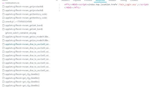

If it starts working, great. The conclusion would be that this is handled incorrectly. The code returns a request to redirect, but it doesn't.
ps.
Looking at it this way, it's not surprising that it doesn't work.
The client reads it with Ajax and receives HTML instead of any data, and doesn't analyze what it received. I can't find where in the code it receives this or if it checks anything from the query.
Maybe adding
websSetStatus(wp, 302);
would help.

Looking at the code, this is simply an error.
No redirect support.
