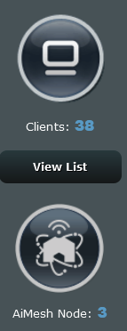

One solid week now on RT-AX88U_386.2_alpha1 on RT-AX88U, backhaul'd AiMesh to AX86U, AX56U, AC86U. Dirty upgrade from RT-AX88U_386.1_2. The weeks operation has been totally seemless for Work, Home & Family (Avg 38 clients). Thanks from the household!!!
PS: Memory used on the AX88U, highest ratio I've seen before.
