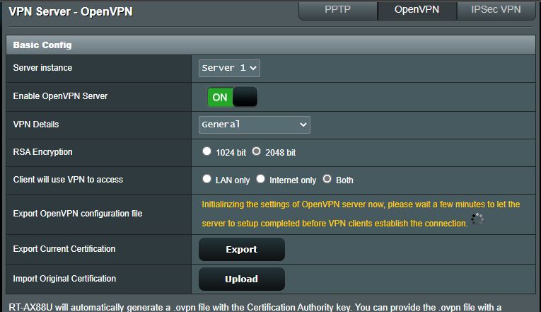

Openvpn server gets stuck initializing settings(see yellow information) forever after server is started. If I restart the server it comes up clean then after a while it returns. Clients can still connect in this status though.

I had the same issue and noticed that changing the port from UDP 1194 (default) to a random one (>1024), makes it disappear. :) Give it a try: https://en.wikipedia.org/wiki/List_of_TCP_and_UDP_port_numbers

Hi bluepoint,
I recalled see this before when I did dirty flash of new Firmware. My workaround was to DISABLE and ENABLE OpenVPN Server and setup again with the same settings. It has been running properly since I did that.

I have the same issue on 386.1_2 on RT-AX88U, so it doesn't seem to be connected to the new alpha version. When selecting Advanced under VPN Details and Apply (no changes) you get the Export button back.
Hi bluepoint,
Ill try to re-setup and see what happens later. If I change the port # for example, should I re-export the config file to the clients? I don't see any option to change the port in the IOS app so I assume a new config file needs to be imported?
386.2 Alpha1 RT-AX88U
Mine was doing that as well. The problem was that NTP wasn't updating the system time quickly enough. It was because of the way I have my network set up so I made some changes, but NTP was definitely the issue.
If you have NTP problem that will cause a lot of services not to start at boot time cause most of them needs correct date and time, however, my Openvpn problem is not related to NTP instead it's more likely self inflicted. :)
