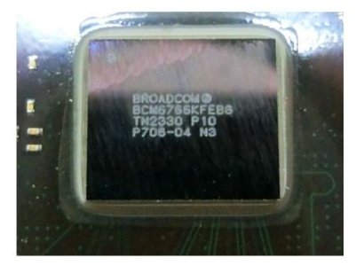

They selected a good mixture of Qualcomm (IPQ5322 and IPQ9574) and Broadcom (BCM6765, BCM6766, BCM4916) chipsets in those routers. Mediatek's MT7988 (Filogic 860/880) is obviously missing, but that's because very few routers are using it (ZenWiFi BT6/BT8 and Archer BE805).
Yeah, but Archer BE550, Deco BE65 Pro, and Deco BE63 are Wi-Fi 7 certified.
Do you know the chipset of BT10?
Most likely Broadcom BCM6765 based hardware.
