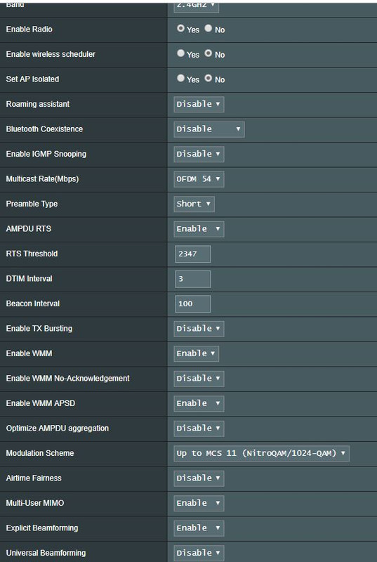

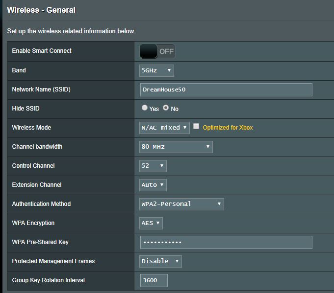

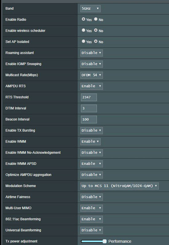

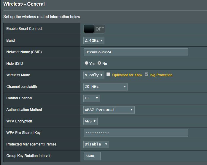

Here my settings
You're maybe right.
Problem is for 5Ghz. Further than 7 meters, signal is very low (wifi signal bar 1 /5).
Here my settings
I don't have time to compare to default settings right now, but for sure I would change the Wireless Mode on both bands to Auto.
On the 5GHz band, I would not use Control Channel 52 either. Choosing 36, 40, 44 and 48 should be your best bet for range and throughput.
If changing the above settings as suggested above and putting most of the other settings to their defaults (and then followed by a reboot and waiting 10 minutes afterward) don't help, I would recommend a full reset via the M&M Config guide to be sure there are no unwanted interactions happening in your current settings vs. anything you've done previously.
The settings are fine. I have never considered changing the Multicast Rate from Auto for fear of impacting the power usage of my iDevices, but this is speculation on my part.
Auto can be interesting in that it shows what a router algorithm thinks are the quietest channels. But in the long run, I prefer to set the channel manually.
On the other hand, 52 is very unlikely to be in use. In 80 MHz mode, 36 to 48 are all one and they are very likely to be in use by others. Hopefully you can do better than 1 bar at 7 meters at 5 GHz on a mobile phone, but hard to say.
Wireless Mode should be Auto, not auto for Control Channels, I think you're confusing them here.
I wouldn't be testing WiFi on a handheld device. These vary too much. A laptop is a better testing device. At least to properly set the channels initially. :)
I should have taken Wireless Mode literally.
