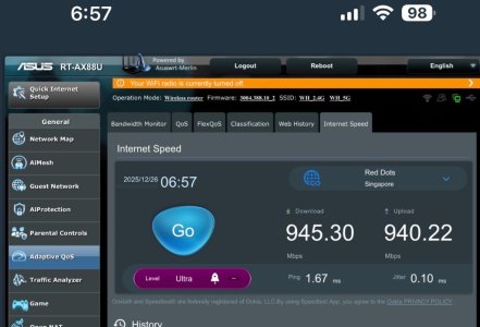

This is speedtest by using ASUS build-in test when FlexQOS is disabled and enabled
The download speed almost HALF of it.
Then, I go to https://bufferbloat.libreqos.com/ to do the test where ASUS FlexQOS is enabled vs disabled. The result is same. GradeC
Question: Can we confirm FlexQOS will also downgrade the internet speed by HALF for download but not the upload ?
Download shaping is only active on the br0 LAN interface, so a speedtest run on the router only goes through the wan interface, so there isn’t a way for Adaptive QoS or FlexQoS to limit download when running the router’s speedtest.
The most likely explanation would be that the router CPU was overloaded during the test, but I wouldn’t expect the upload to hit full speed if that were true.
