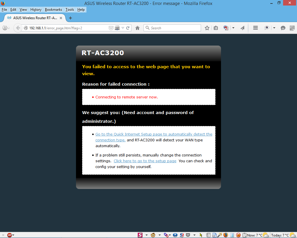

After initial setup and update to v3.0.0.4.378.4129 firmware that was downloaded from softpedia, because the router says "The router's current firmware is the latest version.", even it had the stock firmware, every time I powered the router, after ~100 seconds, the interface of the router is opened in default web browser with this screen:
and after another 20 seconds (without touching anything in router's interface), the internet connection is established. So, it takes 2 minutes and an unwanted web interface pop-up to connect to internet.
My internet connection is PPPOE.

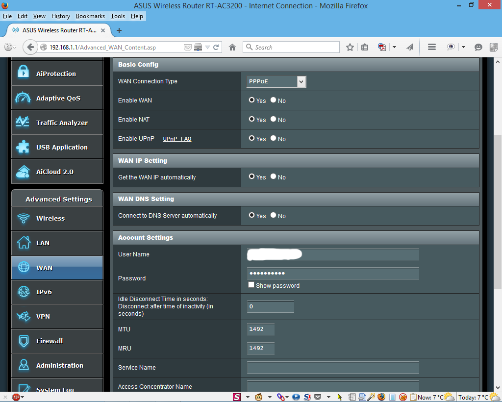

Settings done in router's interface:
Anyone know a cure for these?

You can disable the web redirection on WAN down on the System -> Administration page. All it will do is when the WAN is down you will get an error message from your browser rather than the router's error page.
I disabled "Enable WAN down browser redirection" from Administration>System and I don't have the pop-up after router power on, but I think that pop-up appears because of a conflict or something.
