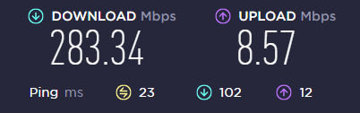

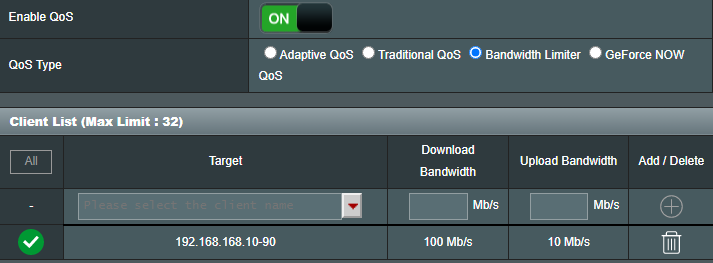

Bandwidth Limiter is NOT working. Max speed no matter what the settings are.
The speedtest on Wi-Fi:
Traditional QoS is also NOT working, upload speed only obeys the rules:
One thing fixed, something else broken... both were working in 388_21709 firmware. :confused:
