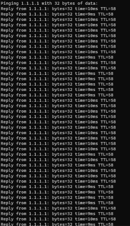

Hi all,
Been a lurker for a while and loving the Asus WRT merlin work, been using it for a while on my GT-AX6000
But for me Im getting packet loss when using 3004.388. 4 Beta 2. I did a factory reset after installing and also tried dirty flash from offical 3.0.0.6.102_21514 to 3004.388. 4 Beta 2 still happening.
My connection is
Fibre > PPoE 900 mbps DL 900mbps UL
MTU set to 1492 everything else set to default
when gaming its laggy as hell on the 3004.388. 4 Beta 2 here is a pingtest to 1.1.1.1 100 times
for comparision here is the offical 3.0.0.6.102_21514 ran exactly 10 mins later
Any suggestions I much prefer to run Merlins build but unable to at the moment
Kind Regards
Sal
Thank you @RMerlin the latest beta has fixed my packetloss issue on the GT-AX6000
