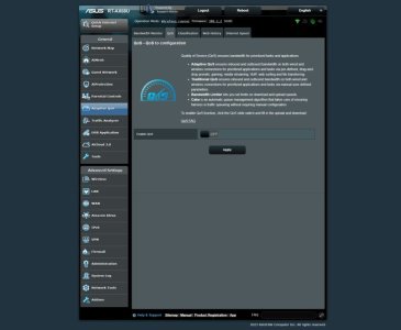

My QoS is disabled.
The Speedtest for wired internet is 5XX, but the WiFi is only at 3XX. After switching back to 388.2_2, the WiFi's Speedtest goes back to 5XX.
My QoS is disabled.

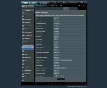

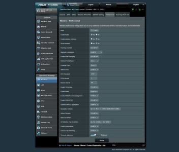

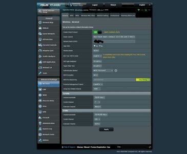

This issue only happen in beta firmware. 388.2_2 does not has this issue.
AC66U+ that's an AP not AiMesh. This AC66u+ wifi does not has problem.
AX68U that's a main router. It has a wifi problem on beta. 388.2_2 does not has problem. The QoS is disabled.
