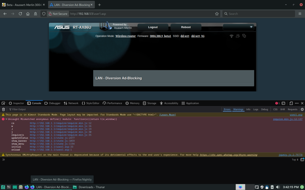

I spoke too soon. Diversion GUI does not render correctly, FF Nightly (x64), Linux
What version? Diversion 5.4.3 contains webui fixes, so make sure you are up-to-date.
Click the “Errors” and “Warnings” options to the right. Those are being hidden right now.

I've made a few changes to the Diversion ASP file to address the errors reported on the browser console. If you would like to test this modified ASP file on your router, you can download and set it up from my GitHub repo using the following commands:
Bash:
curl -LSs --retry 4 --retry-delay 5 --retry-connrefused \
 https://raw.githubusercontent.com/Martinski4GitHub/CustomMiscUtils/develop/Misc/GetDiversionWebPage.sh \
 -o "$HOME/GetDiversionWebPage.sh" && chmod 755 "$HOME/GetDiversionWebPage.sh" && $HOME/GetDiversionWebPage.sh
Once completed, check the Diversion WebUI page again. If you want to be sure that it's working, you can reboot the router after the modified WebUI page is downloaded and set up.
HTH

Thank You. Your modification has fixed the issue here.
