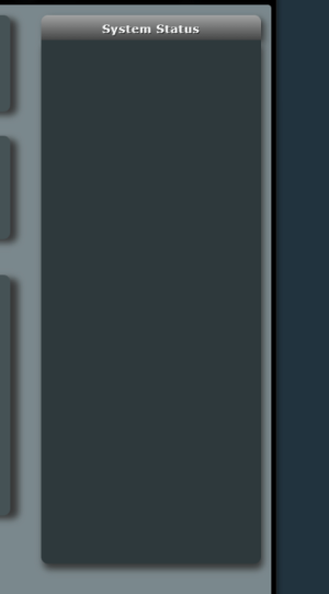

RT-AX58U - network map page shows no details on the right pane.

Folks, if you have weird UI issues, start by removing any addon that modifies your UI. The majority of these issues are caused by these addons. I also remember at least one reported issue was caused by a browser addon..
I don't have any addons installed.
edit: weird issue, when accessing the web UI via IP address the gui shows up ok, I have only SCMerlin installed.
but when accessing via hostname from my reverse proxy the gui shows up like the screenshot I've uploaded a few messages back and I don't see SCMerlin either. very strange.
Then check your browser. I was actually testing someting on my RT-AX58 an hour ago involving the networkmap, and it was loading fine for me.
You can check your browser console for any Javascript error that might provide more info as to why that frame is failing to load.
please see my edit above, as far as I recall this problem wasn't present in 3004_388.8_4.
SCMerlin is the very definition of an add-on that modifies the UI with it's Add-ons submenu and sitemap.
it was installed before the update and worked fine.
after the update it wasn't installed (got uninstalled somehow?), I've just reinstalled it.

Revretting to the previous version with scmerlin installed is working as it should.
As Merlin asked, check your browser console (F12) to look for errors. Don't assume scMerlin has been updated yet to account for changes in this Beta. Rolling back the firmware doesn't prove who is to blame in this kind of situation. One version of scMerlin has to accommodate multiple versions of the firmware.
no js errors that I can see.
the problem only happens when I connect to the web UI via https through my reverse proxy, I don't know what's not playing nice because when using IP address everything works great.
That does not mean that it's the firmware that's broken. These addons make a lot of assumptions about the rest of the webui, and things change over time. These addons need to adapt to these changes - that's on their respective developers to fix, not on me.
I even tried factory reset and didn't install scmerlin, the problem persists.
Are connecting via hostname or ip?
