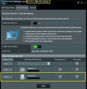

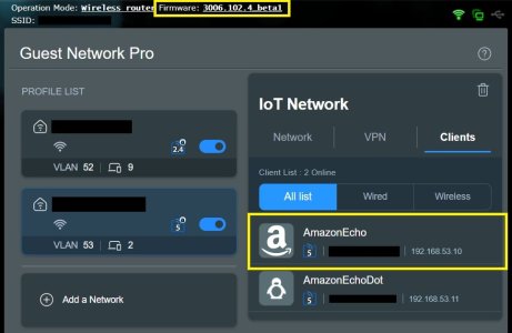

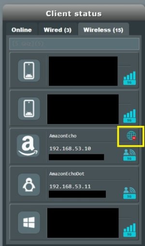

It appears blocking internet access to Guest Network Pro clients (on a per client basis) is working with the Beta. This was something that wasn't working properly with the stock Asus 3006 firmware on the RT-AX86U Pro. Set up the blocking through the Parental Controls > Time Scheduling section. Asus app for Android also appeared to work blocking Internet access to a Guest Network Pro client under Parental Controls > Scheduled Block.
