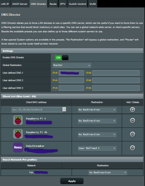

When I read the changelog 3006 file for betat2, I saw that I had to learn about vlans since the setup I've been using for some time uses the earlier definition of "Router" in global redirection. So this afternoon, I decided to see if I can get the new definitions setup. First I updated the RT-AX86U-Pro firmware to beta2 (from beta1) and after the router rebooted, I went to the LAN page to see what had happened. Nothing, everything worked fine. 3 hours later everything is still working fine. The (2) Pi's get static IPs, the DHCP Server has those IPs in the DNS server fields, when I open up the pihole admin pages there is no huge amounts of traffic on either Pi.
I was surprised at this and wonder if I'm missing something.
Note what was indicated earlier in the beta discussion:
https://www.snbforums.com/threads/a...ta-is-now-available.94366/page-16#post-952220
And a heads-up for Pi-Hole users that rely on DNS Director to force clients to use the Pi Hole, you need to now add the Pi-Hole IP from LAN DHCP DNS 1 as a "User defined DNS" in DNS Director and set that mode instead of Router.
And what was indicated in the 3006.102 change log: https://www.asuswrt-merlin.net/changelog-3006
- CHANGED: Setting DNS Director to "Router" will now always
redirect to the router's own IP. Previously it
would redirect to the first DNS server configured
on the DHCP page (which defaults to the router
itself).
If you need DNS Director to redirect to an IP
configured in your DHCP settings, use a Custom DNS
entry in DNS Director. This makes it more consistant
with what the name implies, and was also necessary
for improved Guest Network support.
The solution, as indicated, is to input the Pi-Hole IP address into one of the the User Defined DNS fields, then change Global Redirection from Router to that User Defined DNS #. Example with a setup running two Pi-Holes.
How does that work for the second Pi?
It doesn't work for a second Pi-Hole. It will redirect to what ever single IP address you put into the User Defined DNS field that is selected for Global Redirection.
Edit to add: Keep in mind, when DNS Director's Global Redirection is used in conjunction to the Pi-Hole IP addresses input into the LAN > DHCP DNS fields and or any manual DNS addresses input into the manual DHCP IP addresses it is likely the global redirection by DNS Director is rarely used. Typically it would be only those few requests or devices that try to bypass the previously configured DNS addresses.
