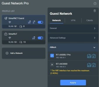

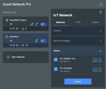

This might be a shot in the dark, but I see you're using 3006 Main with 3004 (but not 3006) capable nodes, like me.
Propagation of bands to nodes differs depending on if you use nodes with Pro (3006 branch FW) or non-Pro (3004 branch FW) nodes (see rest of thread too). When @visortgw started looking at this he concluded that:
the limit of two devices per band per node (plus primary router) total has been lifted when all nodes are running 3006. I can push 2.4 and 5 MHz IoT and guest networks to all AiMesh nodes.
So if you can only run 3004 on the nodes, there is a limit to how many bands you can propagate per interface. Here's someone with a similar limitation. If you're only seeing one band (you base it on what you can connect to?), maybe it is related to this; or maybe not.

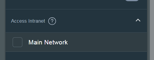

AX86U-Pro: In Guest Network Pro, if you configure a guest or iot network and select "use same subnet as main network" the guest/iot clients can reach everyhting inside the main network. In the previous 3004 release this was blocked. They used the same ip subnet but could only reach the internet. Is this a bug, or a new "feature"? If it's a feature, it makes gues/iot network useless if you select "same subnet", so be careful. Also, < and > are no longer allowed within a guest networks wifi key. Both are no show stoppers, but to be mentioned.
Dirty upgrade. System is main of RT-AX86U Pro (was 3004.388.8_4) and wireless AiMesh node of RT-AX58U (3004.388.9, upgraded earlier this week without issue). I did NOT remove and reattach node yet. All clients successfully reconnected without issue including two main 2.4GHz/5GHz networks (separate SSIDs), GN1 @ 2.4GHz across node and GN1 @ 5GHz just at main. Only change they saw was the new subnets from 192.168.101.x and 192.168.102.x to 192.168.52.x and 192.168.53.x, respectively. ssh works fine (key length is RSA 3024). amtm works and shows no updates. Tailmon successully monitoring tailscale - so entware looks good too. Let me know if there are any areas you would like me to check before I try out any of the new functionality of 3006 (and accidentally screw it all up lol). Thank you for all your hard work!
Did you notice this button?
And there is also a Set AP Isolated switch to prevent communications between connected Guest devices...
