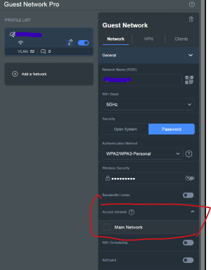

Have not checked it in this Asus-Merlin 3006 Beta yet, but under stock Asus firmware on an RT-AX86U Pro that option (Access Intranet), when unchecked, didn't work when one has Use same subnet as main LAN enabled. See my comments in the stock Asus firmware discussions:
Only way I could get the Guest Network Pro isolated from main LAN was to disable Use same subnet as main LAN.

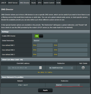

I have not been able to get this to work.
Works for me, my clients connect just fine now (DNS Server Default in Guest Network).
And I do have DoT, DNSSEC, DNS Rebind protection enabled...
Also not on same subnet if that matters.
DNS Director is working for Guest Network Pro Profile clients on a RT-AX86U Pro. I've experimented with Redirection for a Guest Network Profile set to; No direction, or Router or User defined 1. Worked with all three settings, The Guest Network Pro Profile clients could access and surf the internet. PS: User defined DNS 1 is set to a Pi-Hole device IP address so I can run my Guest Network Pro Profile clients through Pi-Hole.
Edit to add: Current working DNS Director setting attached. User defined DNS 1 is a Pi-Hole device.

Thanks for confirming. I reconfigured to Router and Default for both guest networks, and I rebooted entire network. As you stated, it does work!

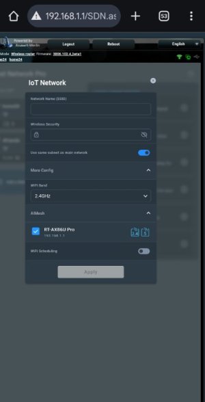

AX86U-Pro: In Guest Network Pro, if you configure a guest or iot network and select "use same subnet as main network" the guest/iot clients can reach everyhting inside the main network. In the previous 3004 release this was blocked. They used the same ip subnet but could only reach the internet. Is this a bug, or a new "feature"? If it's a feature, it makes gues/iot network useless if you select "same subnet", so be careful. Also, < and > are no longer allowed within a guest networks wifi key. Both are no show stoppers, but to be mentioned.

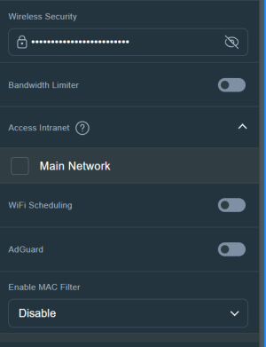

As long as you disable "access to intranet" in settings, you'll be fine even if you use same subnet as main network. This way the main network can access the GN and not vice versa.

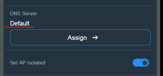

Did you notice this button?
And there is also a Set AP Isolated switch to prevent communications between connected Guest devices...

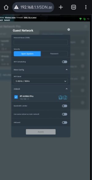

Thank you, but there is no such button on AX86U-Pro.

As long as you disable "access to intranet" in the advanced settings, you'll be fine even if you use same subnet as main network. This way the main network can access the GN and not vice versa.
Makes sense, but there is no such button in the AX86U-Pro (or I'm blind). :)
Its the same problem, when Use same subnet as main LAN is enabled, that has been repeatedly complained about in the stock Asus 3006 firmware. Made several lengthy posts about it in the past pointing this out in the stock firmware last year when Asus released the 3006 firmware for the RT-AX86U Pro. See here and here. The Guest Network IoT preset default settings simply doesn't work like one would expect, clients isolated from main LAN. I stopped using the IoT preset and use the Customized Network preset in Guest Network Pro, and have Use same subnet as main LAN disabled.

Not there, but after
Not there on my router, only the ap isolation feature. No idea why this button is missing. But as bennor wrote it seems to do nothing at all even if it's there?
Your screenshot is from an AX86?
