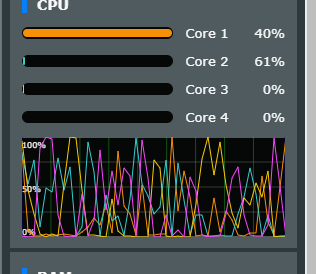

Installed 386.1 Beta on my AX86U.
Everything seems fine so far - I'm very happy - only one thing is odd - the CPU Statistics are crazy - spiking around the whole time in "idle" - BUT with HTOP there are no services or things with high CPU usage - so it seems to me it's just a visual bug ?!
View attachment 28280View attachment 28281
Do you have a USB stick plugged in with UIDivStats script installed? If so, SSH into the router, go to UidivStats and turn cached mode on. The issue is a slow USB stick if it is this.
