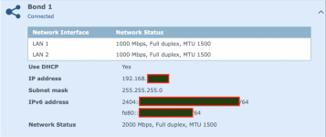

Only issue /I have is that my Synology (link aggregated) no longer agreed with dhcp, I worked with a manual address though. Any thoughts? Rebooted router and unify managed switch. Worked flawless under 314.19?
Raphie,
I have a Synology DS918+ connect to LAN Port 1 & 2 of my RT-AX88U. After reading your post, I decided to turn ON "Bonding / Link Aggregation" . It seem to be working. (So that you get one more data point). Hope you resolve your issue soon.
